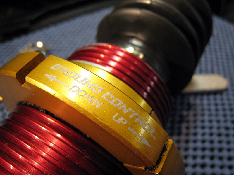

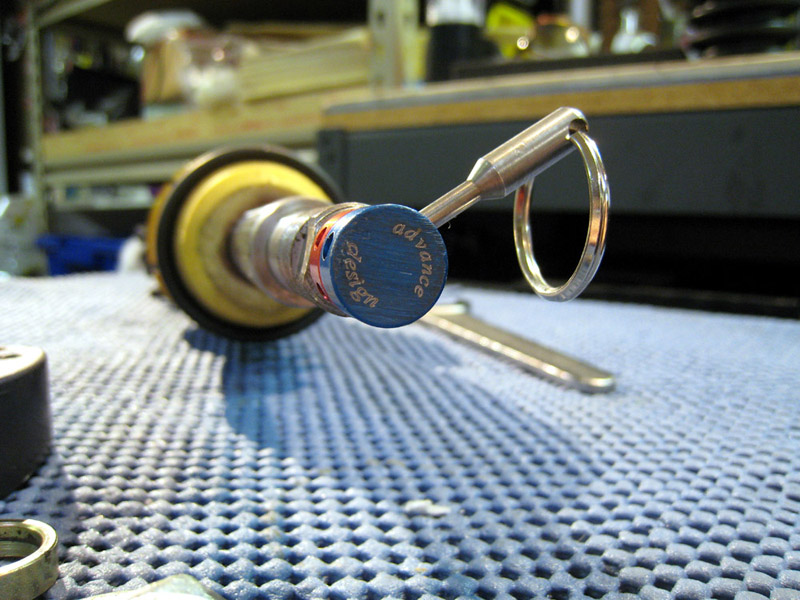

Michel directed me to this thread to provide some information on our Advance Design dampers and Ground Control parts so I'll do my best.The Advance Design dampers are a motorsport damper designed primarily for competition use. They are custom built, custom valved, and spec'd around the car, driver, and intended application. The front Advance Designs are double external adjustable via two stacked aluminum knobs and are accessed under the hood. They are adjustable both in rebound as well as compression. Rebound is infinitely adjustable throughout the range and compression is adjustable at 3 levels. In addition, the dampers are high pressure monotube with external nitrogen ports. Front struts are DOM alloy machined housings and are powdercoated. Spring rates are custom spec'd for each application and the fronts are designed to work with our Ground Control camber/caster plates which are CNC'd billet anodized aluminum. The camber plates incorporate an aerospace spherical bearing and load bearing top hat. Threaded body of the strut is anodized aluminum with a split ring single unit adjusting collar for ease of adjustment and to prevent seizing. Rear Advance Design dampers are also custom built, custom valved for each customer application. On the TT Quattro, they are aluminum bodied for reduced weight and inverted for better management of unsprung weight. They are also high gas pressure monotube. Mounting points are spherical bearing for precise motion control and the dampers are external double adjustable again in rebound and compression while on the car. Rear springs are also custom spec'd and are on height adjustable perches utilizing the same split ring collar design. Nitrogen ports are at the top. The Advance Design damper shafts are hard chromed and have 135,000 psi tensile strength. Aerospace bushing material is used to hold up to high lateral loads from racing. Dampers are fully rebuildable. All dampers come with an actual dyno chart.
As for the camber plates. Ground Control Suspension made its first set of camber plates in 1993, over 10 years ago. These plates, designed for racing, incorporated many features that were previously unavailable at any price. Some of these early features include: sliding caster adjustment, offset sliding bearing, multi-position bolts, adjustment markings and multiple bearing assemblies. Ground Control designs and builds racing parts, with the same goal as racing itself: The desire to be the best. Since the earliest Ground Control camber/caster plates, there has been constant improvement and innovation to continue being the leader. Some features of our camber/caster plates are quite unique. Probably the most striking innovation is the separate bearing surface for the spring loads. This assures that when the strut changes its angle with the chassis, the spring can also change its angle, without overloading a centered bearing. Early in the development of our CCP, we did try to allow the spring to actually pivot ON the single bearing, but carrying the entire weight of the car as an axial load, even on a very large bearing did not last. It also made the engineers at the bearing company roll their eyeballs. Our early testing without needle bearings also forced the spherical bearing to rotate, which significantly reduces the load capability, i.e. dynamic vs. static loads. The modern GC method of carrying the spring load on a separate bearing, allows the spherical bearing to have an extensive safety margin. The separate spring bearing surface is then equipped with needle bearings in order to allow the spring to actually rotate when steering. Some data: Spherical bearing housing failure: 102X cold rolled steel 21780 lbs 6061 aluminum alloy 13167 lbs Spherical bearing maximum load: Shock and 550 lb spring combined +2263 lbs Shock only, spring separated (GC) -400 lbs Safety factor (bearing rating/max bearing load) 5/8 bearing, spring and shock 2.1 3/4 bearing, spring and shock 2.5 5/8 bearing, shock only (GC) 6.9
